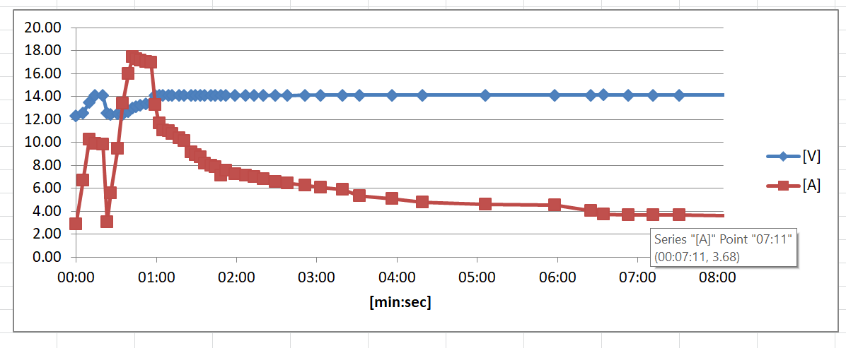

I have followed some of these threads and did some testing and measurements on my M440i MHEV. I have not had a need to charge my 12V battery so this was just testing out of interest (and i preparation to know what works if needed). Further, I don't have an outlet where I park but I have a "CTEK CS Free" that initially is capable of supplying up to 20A.
My guess is that the MHEV system in these cars does something funny for a while after connecting a charger while consuming a high current. I haven't measured the current to the 12V battery but the voltage at the charging posts stays normal so my conclusion is that the current to the battery is not too high. As can be seen in my voltage/current plot the current rise to 17.5A at the beginning but then reduces while the voltage increase to a normal charging voltage of 14.1V. A car charger which is specified to be used on a battery while still being connected to the car should be safe to use even with a high current rating because it will make sure that the voltage doesn't exceed 15V or so. No cycling of click noises was heard.
Attachment 3003436
20 A is higher than 5 or 10 and pretty close to the minimum of 25 (or suggested one).
The problem is that the clicking is present in some models and that is worrysome. I will not leave that charger in there and have that grinding and clicking noise non stop as I don’t believe is ok; ai contraire.
(In regards with your CTEK CS FREE, is intended for Lead acid /Lithium-ion so not sure how that works on the trunk AGM battery).
Either way, 20 A still seems aggressive for the battery charging requirements. The 5 max 10 are suggested for the battery as they are more lenient.
Probably if you use the regular 5 or 10 Noco, you will experience the same problem?
