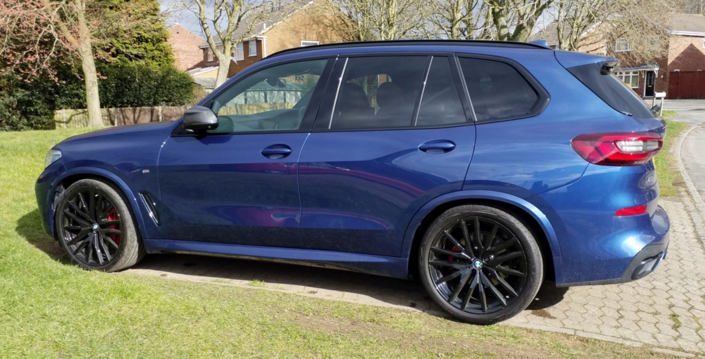

I did a quick non contact maintenance wash on my X5 over the weekend. I just couldn't be bothered to get out all my gear so I took some on my kit with me to my local jet wash. I mixed up 2 litres of Bilt Hamber Auto Foam @ 80ml to 1920ml of water for my Marolex pump sprayer and the same amount again for my BigBoi electric foamer. Firstly I soaked the car using the pump sprayer then I foamed over the top of that (probably a bit of overkill really) using the BigBoi. First time I'd had chance to try out the electric foamer, I have to say that I was very impressed indeed, 2 litres was ample to cover the car including under the arches (the actual capacity of the foamer is 1.8 litres but you can get a full 2 litres in it) after giving it all a good rinse off I did another rinse using spotless water. I then went for a quick blast, in sports plus mode, down the nearby duel carriageway just to blow off some of the water. For saying it was a completely contactless wash I'm pleased how it came out.
It has PPF applied to the full front end, headlights, mirror caps, A pillars, sills (rockers) and the door jams, it is also fully Gyeon ceramic coated too.

Absolutely. The more layers of anything, wax to PPF, that is between the paint and your eyes, the less glossy the look will be, physics be like it is.

I've had similar positive experience with non-contact wash and surprising results.
In a cheap $8 garden sprayer from Lowes, I mix concentrated car shampoo:degreaser:bug remover at 3:1:1 ratio with water. Pre-soak the car with my mix and then $2 at the local self-wash gives me 4 minutes of pressure washing to get her 90% clean.
I've also been using the same method without the pressure washer and just the rain that we've been getting in California recently.
